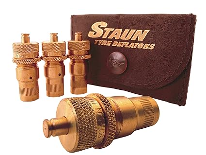

Nice topic and indeed you covered almost all type of deflator for offroading except one more which I have used: Staun.
People love their automatic deflation to precise psi you set them, but I couldn't master that PHD after months and lack of patience made me choose stem removal - fast, easy and F.Cheap. Carry valve stem whole strip that has 20 (i guess) and it cost 5 AED. After little practice, I stopped losing them and hardly replace new stem ever.
If someone or Staun can set their deflator to 12 psi and ship them, I wouldn't mind trying them again as they sound too good to be true, but yes time-consuming.

1 hour ago, Gaurav said:
Nice topic and indeed you covered almost all type of deflator except one more which I have used: Staun.
Image result for staun deflator
I also gave a try then gave up after 5 or 6 attempts, for the same reason. The only thing I will regret is the nice brass quatuor music you can hear when you deflate.
I have used these too. The method to set these is easy.
My 2 cents -
Pros: Can deflate all of them at once.
Cons: Takes long as it deflates slower once the psi lowers. Not always accurate. The "programmed" setting can get loose in the bag.
  • Like 2
  • Thanks 1
Absolutely frustrating, and I forgot to mention that. Thanks @Jocreative
I never knew this secret before and always thought that last time I did some goof up. Damn bag.
Maybe they need to develop some locking setting spring mechanism than just simple twisting.
