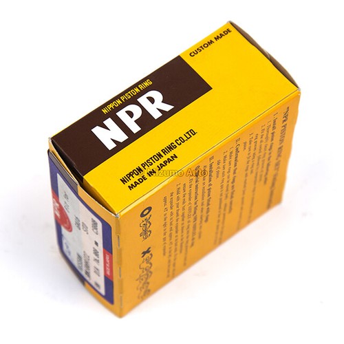

Thanks guys for wonderful help. NPR supplies for Mitsubishi :-)
https://www.npr.co.jp/english/company/company02.html#pagetitle05
SWM31121 NPR Piston Rings Fit 94-04 Mitsubishi Diamante Montero 3.5L 3.5L SOHC DOHC 6G74
NPR-Piston-Rings-Fit-94-04-Mitsubishi-Diamante-Montero-3-5L-3-5L-SOHC-DOHC-6G74
Engine Valves - Aftermarket good company
1 hour ago, desertdude said:
Last line says available only in standard size so if your are going oversize doubt they will fit
In further description it says for oversize, ask before ordering so I sent the email and waiting for there reply.
