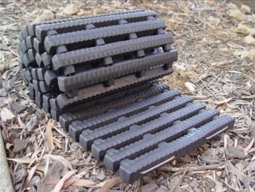

Bushranger X-Trax Sand Tracks (Pair) (Off-Road Recovery)
