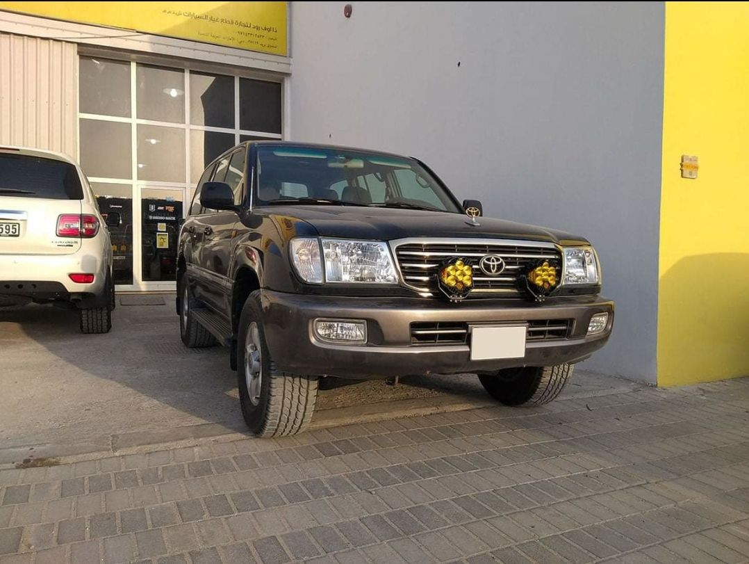

I really enjoyed my first night drive and was lucky to be following Hisham with his amazing lights and more experienced driving. I could  see my old technology halogen lights wouldn't work well for night drives.
After having just a small time in the dark on our last afternoon drive, my wife said no way she is going on night drives with our stock headlights. That's all I needed to hear before heading off to off-road parts shop. 😁
 Hoping these lights help give me a little more space for momentum and provide a little more confidence to the wife when she decides to come along. 😁
Screenshot_20210531-104400_Facebook.jpgpan widget

On 4/20/2021 at 9:00 AM, Wade Pat2 said:
If you read this far you may think I am crazy to spens this money on such an old car.
Ain't crazy bro, try buying the cheapest LC200 you can find versus cheapest LC100 + mods, a very different & satisfying feeling to get LC100 on the cheap and able to customize it to your liking 😄
