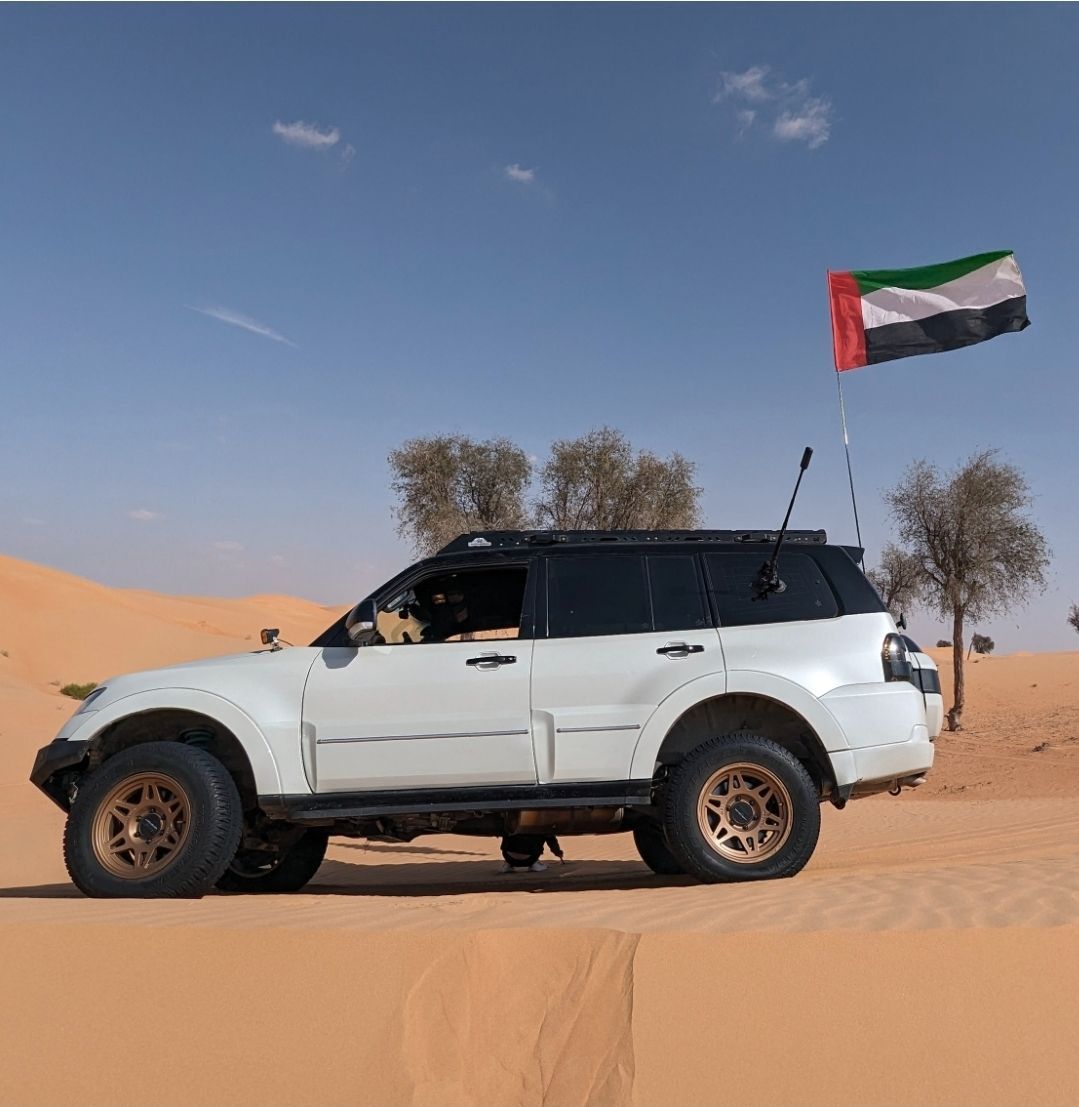

Hi. I got the method 706 on my Pajero.
If you google the official supplier of method wheels in Dubai, then go to their shop they will show you the exact wheels which are known to fit Pajero on the correct offsets.
@Andrew John Melvill has some nice aftermarket wheels on his Pajero, think they were lenso brand but I'm not 100% on that.... 😅
