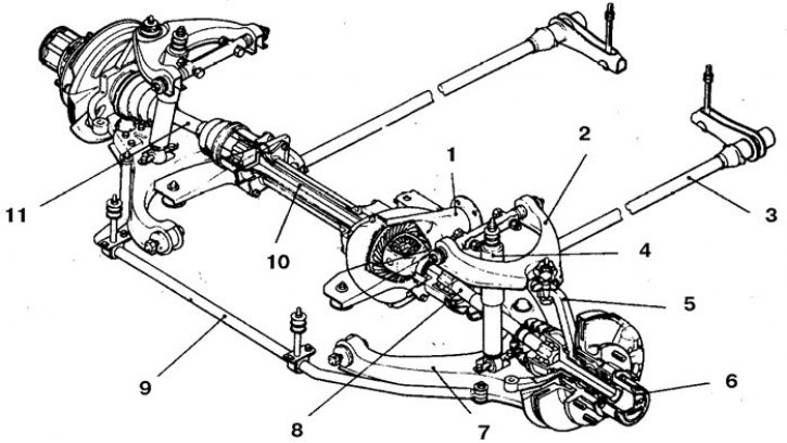

Frederic Posted May 14 Share Posted May 14 Fantastic write-up @ChrisW and something i have been going through myself with the Trooper. In the early days i had the car, it felt planted and behaved quite well in the sand, but since i moved from 33 to 32 inch tires, and installed a winch in the front, something started to feel off. The car would nose-dive and bounce a lot but i could not immediately find a root cause. I started to experiment with a few different models of shocks. There are not so many options available but i think by now i've gone through 3 or 4 different models, even adjustable ones, and still could not get the predictability on ridges my Pajero used to have. Now recently i've upgraded the torsion bars from OEM to Ironman Heavy Duty and finally i am getting back to a somewhat normal behavior. Now also Bilstein shocks entered the game (basic model) and the progressive dampening is helping the front to settle a bit. I made a few mistakes from spending time on US forums about Isuzu Trooper, where the majority of these people set them up for crawling or overlanding, and choose very stiff shocks (KYB Monomax came as recommended). This did not work well for me. Long story short, the way we are in tune with our vehicles is key, and whenever something changes we need to adjust our senses and listen to what the car is telling us. This might mean doing some lower level drives, or the exact opposite. Whatever works for you. I've been lucky to be able to drive and test different offroad vehicles over the years and they all feel different. In the club we always encourage people to learn by using their stock suspension, and i still stand by that statement, but the amount of vegetation has forced many of us to look for better shocks. Either this or visit the chiropractor every week 2 1 1 "Go as far as you can see; once you get there, you'll be able to see further." Link to comment Share on other sites More sharing options...

Zubail Posted May 14 Share Posted May 14 3 minutes ago, Luke K P said: extra weight in front of front axle = you should look at heavy duty SPRINGS. I had the same with changing the bumper 😄 Funny thing, once I installed roof rack, it little bit balanced bumper, and even last time on Big Red it was not that much nose diping! but still I want Kings 😆 maybe @ChrisW will recommend some shop for it ))) 1 Link to comment Share on other sites More sharing options...

Frederic Posted May 14 Share Posted May 14 44 minutes ago, Luke K P said: extra weight in front of front axle = you should look at heavy duty SPRINGS. you need to restore the front of the car to the unloaded 'factory' height position as rest. shocks will be nice for damping impacts, but the heavier duty springs will control the load and the bounce effect to bring it back to 'factory spec'. Amazing how little weight change hanging over the front bumper will change characteristics. Next time we meet you need to try to find springs on the front of my car buddy 😆 There is none.... 4 "Go as far as you can see; once you get there, you'll be able to see further." Link to comment Share on other sites More sharing options...
Luke K P Posted May 14 Share Posted May 14 24 minutes ago, Frederic said: Next time we meet you need to try to find springs on the front of my car buddy 😆 There is none.... WELL THERES YOUR PROBLEM! 😎 2 Link to comment Share on other sites More sharing options...
