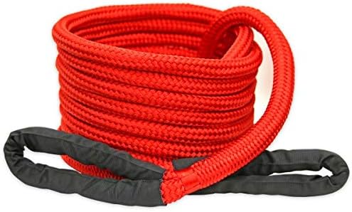

- A Snatch rope (flat) or Kinetic Recovery Rope (round) is a rope made of Nylon that allows to stretch for about 20%, and is extremely useful for offroad recovery as the stretching creates a kinetic energy and the recoil effect helps in recovering vehicles stuck in the sand.
AOR Kinetic Recovery Rope, Aor60-3K
When choosing a kinetic recovery rope, you should select a rope that has a breaking strength of 2-3 times the weight of the vehicle you will recover. For example; if you recover a Nissan Xterra which weighs 2 ton, the breaking strength of the rope should be at least 6 tons. Most recovery ropes have 10-15 Tons breaking strength. The reason for this is that the forces involved when a vehicle is completely stuck in the sand are far higher.
