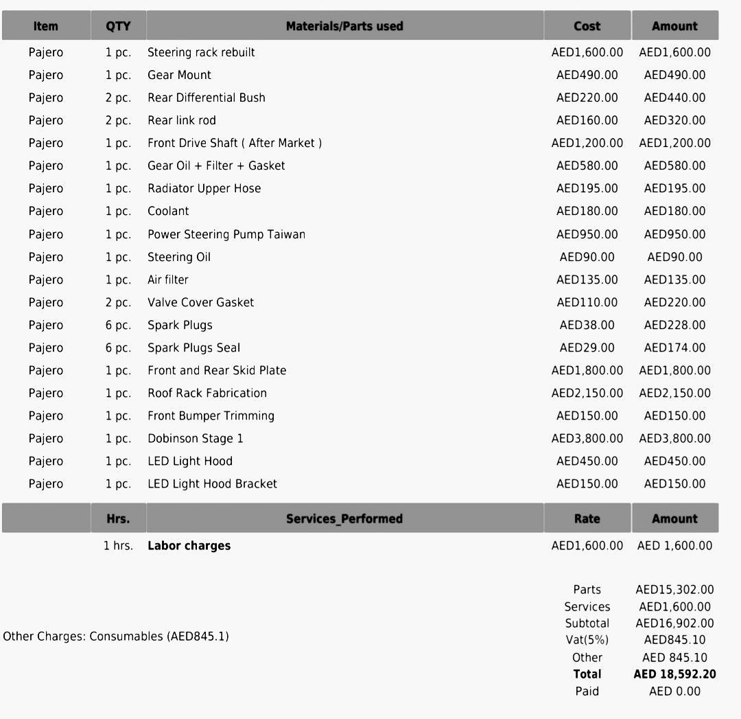

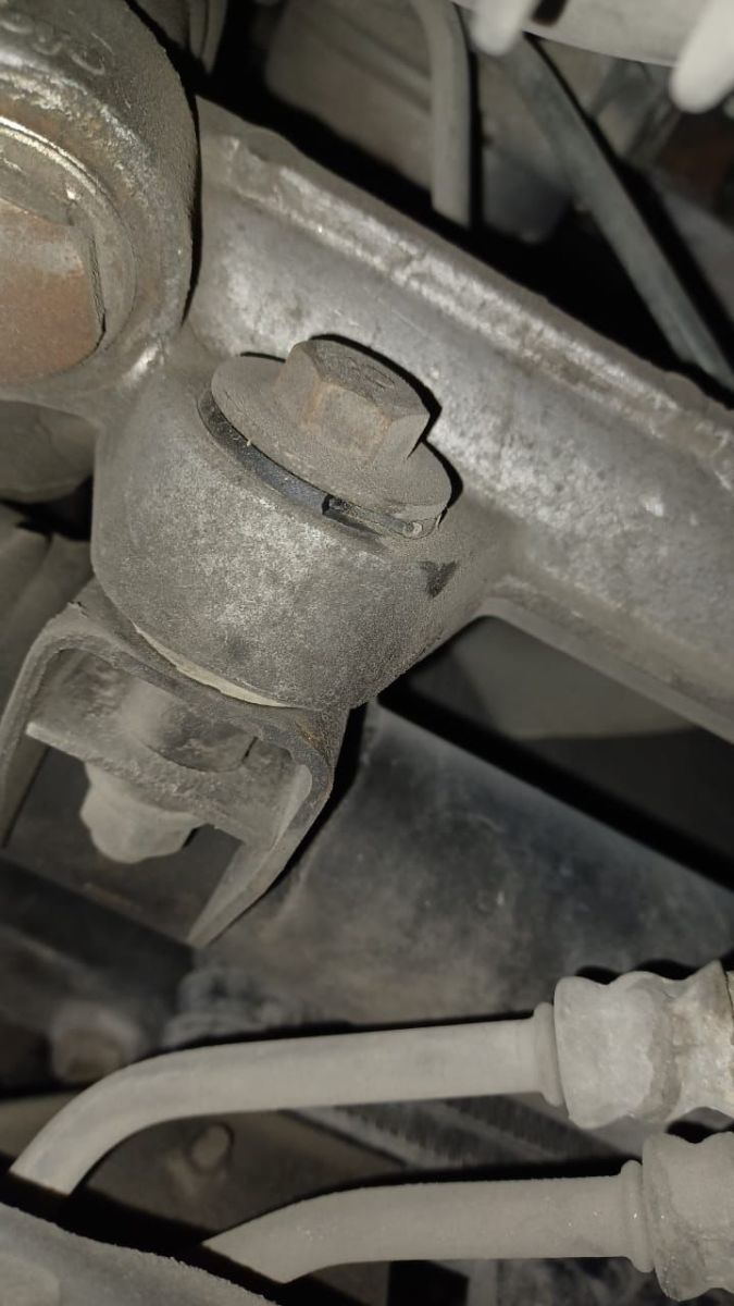

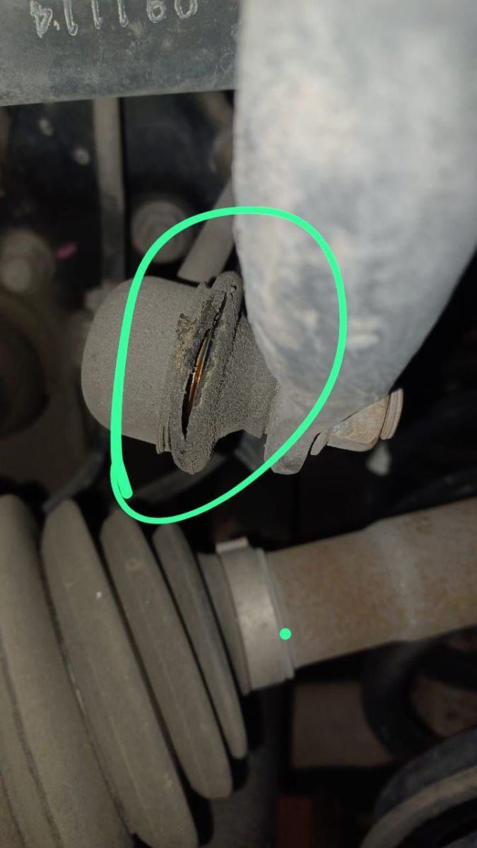

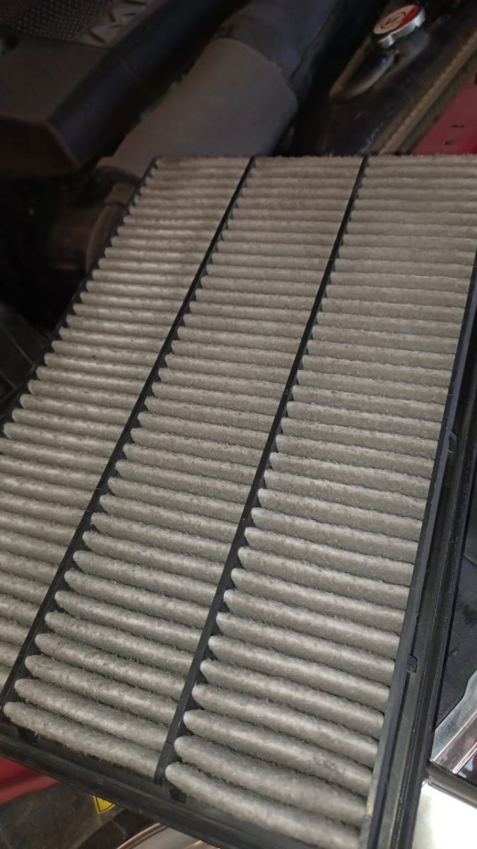

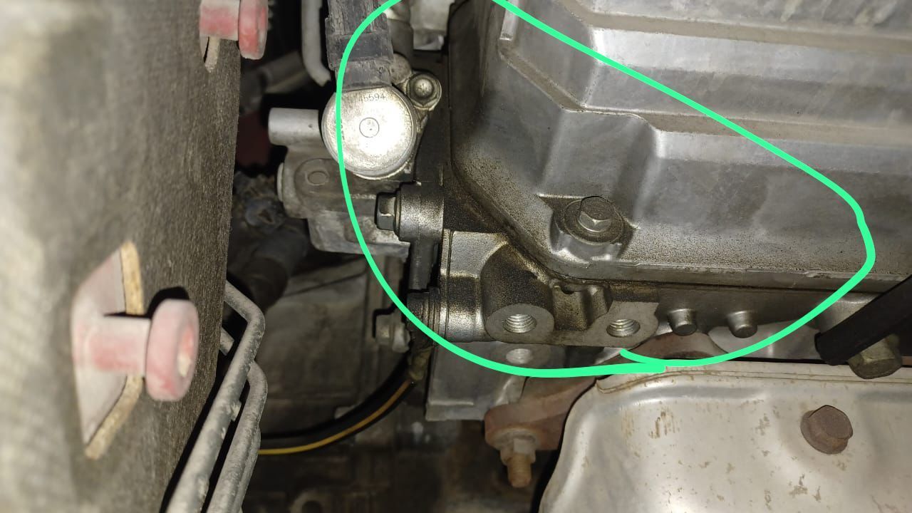

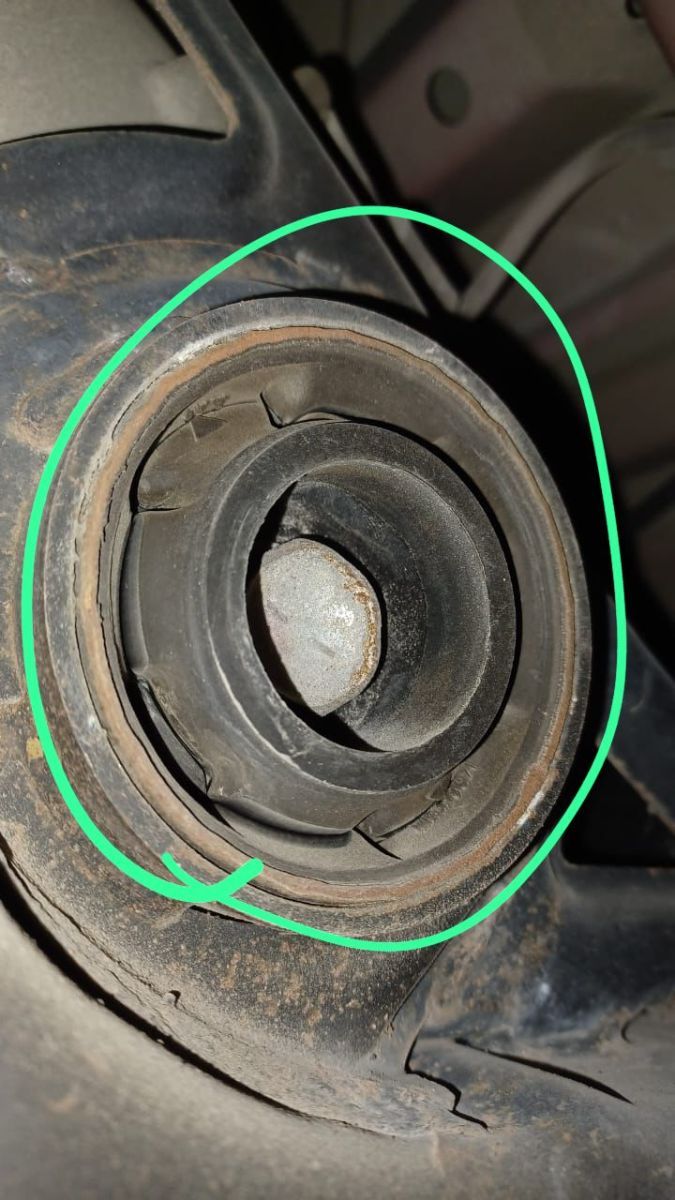

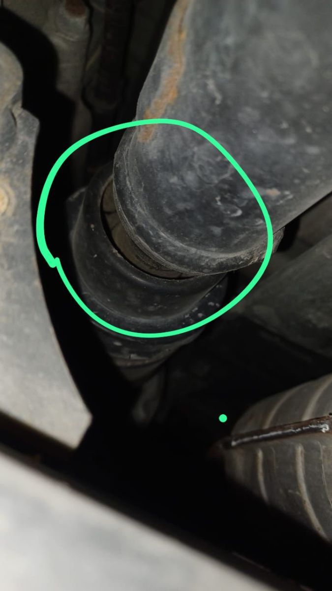

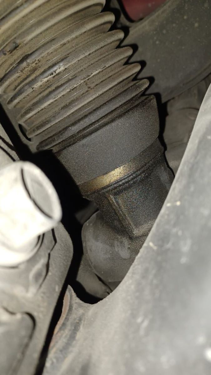

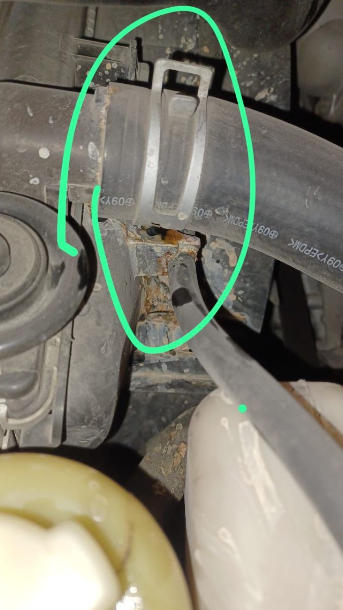

I’d appreciate your thoughts on a quote I received for my pajero 2010. one of the issues i am facing is with my my steering—it’s stiff and makes noises whenever I turn left or right.
I've attached some photos that the garage provided.
Appreciate your opinion on this.
Thanks a lot!
Looks like valid points to me, but not always easy to spot on the photos as mechanics will look for excessive play which is something we cannot do here 😅

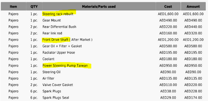

So many diff maintenance in one go, seems not related unless you've recently bought this Pajero.
Especially these 3 out of the below ones.
@Pats would recommend to go for a new steering rack than a rebuilt one… rebuilt ones don’t seem to last very long, especially with off-roading… the price quoted is too high as well.. also better to buy OEM parts yourself from Mitsubishi…
Thank you so much for your help, everyone! @Gaurav, that’s exactly what I was thinking. It seems the issue might just be with the power steering pump, so I may not need to get into rebuilding or repairing the steering rack.
@GauravSoni , to be honest, this is the fifth garage I’ve visited. It feels like everyone’s trying to take advantage in some way. The lack of transparency in this industry is really frustrating. That’s why I was asking for a recommendation for a garage you guys trust-someone who’s honest and does quality work, regardless of the cost. I really hope you guys can help me with this in a private message or anyway possible.
