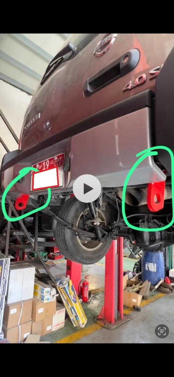

Let me expand on item #2 a bit more. All specialised offroad garages install recovery points specifically designed for Xterras. They are made in local mills. They come in either 8 mm or 10 mm steel and are bolted to the chassis.
Costs varies but last time I enquired I was given the price of 1,000 AED for 8 mm and 1,200 AED for 10 mm for the second option. Attached is an image for reference.
