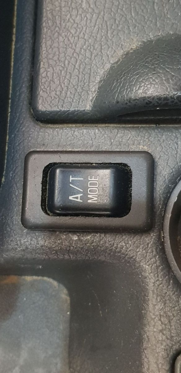

Check AT switch near ashtray.

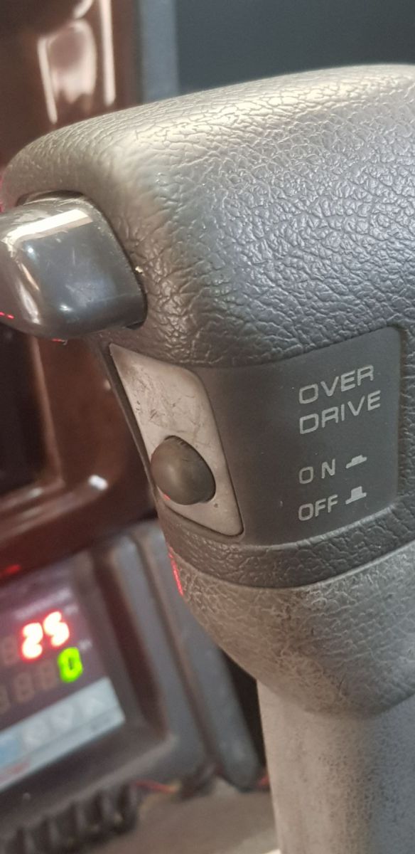

Check OD switch on gear knob.

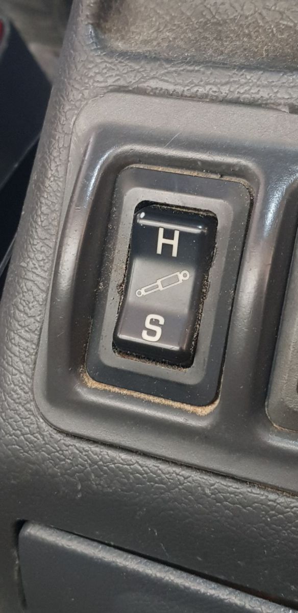

Check suspension setting switch under armrest.
All these 2 or 3 switches wiring is passing through center console, so if previous owner installed some electric mods and opened this area, must have spoiled the wiring.
In my case I added 6 switch gang panel to put all electric fan, light in one place and after few months this drama started.
It was hell and back to explain this problem where all were pointing to old car, change gearbox, change car kind of non sense feedback. Finally I chase my old electrician who installed the gang panel and told him to check all cables and within half day, car was back to normal after struggling for 2 weeks.
