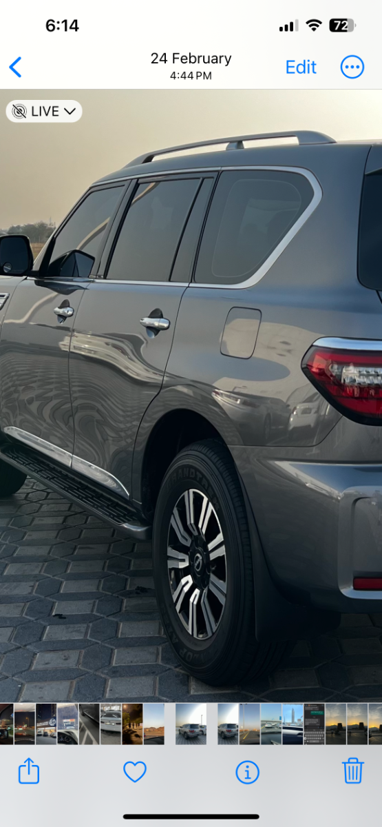

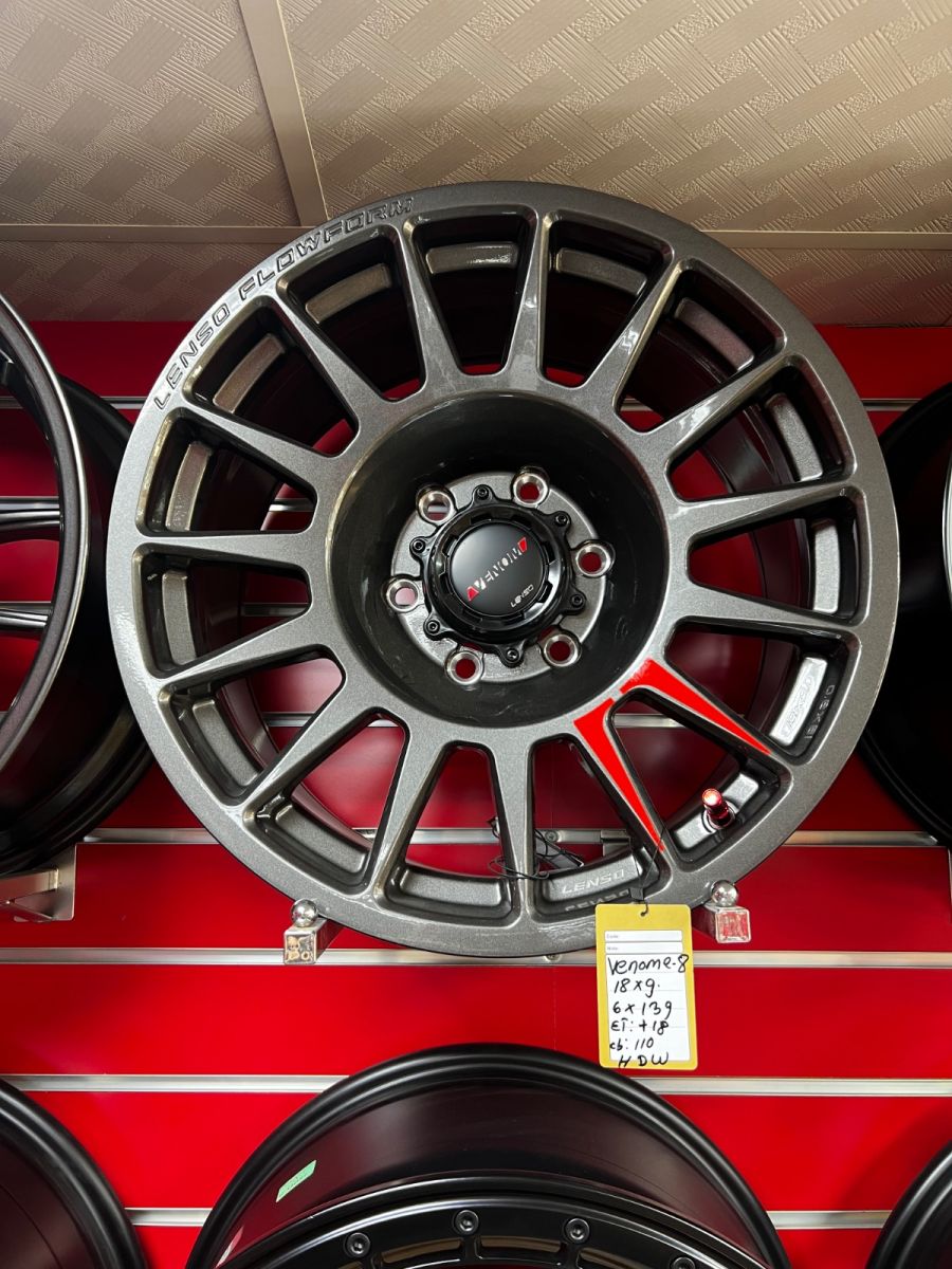

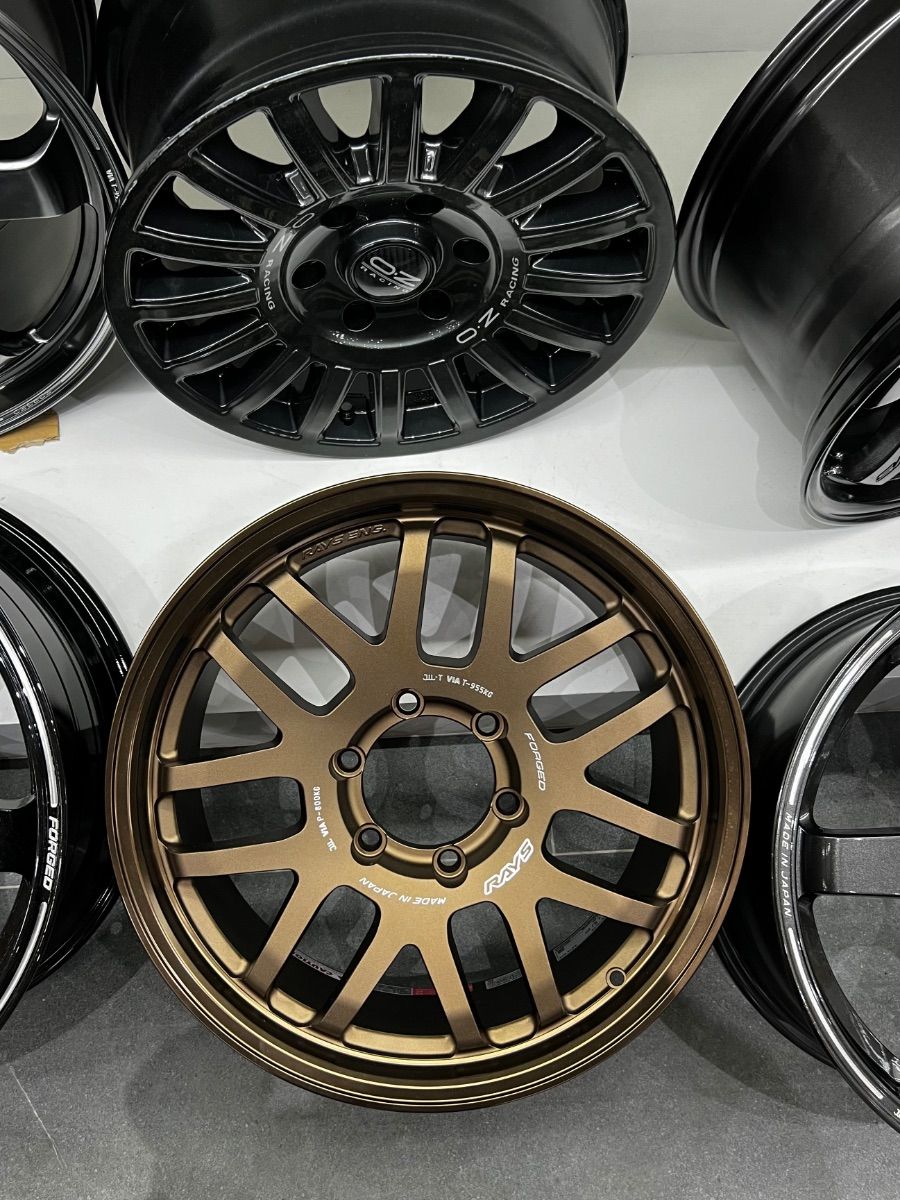

Kunal T Posted July 7, 2024 Share Posted July 7, 2024 Hi guys, I just visited a few shops around Ras Al Khor today as I am considering changing the rims on my Y62. I was looking at 18” rims (current size of the stock rims) that would fit my current tires. I'm wondering if anyone has any experience with whether new rims affect the PSI readings on the dash, or if it's fine because I'm getting the same size that fits into the same tires? or any potential problems I might face Here are a few options I came across… Also sharing what my stock rims currently look like Thanks in advance !! (p.s I just joined Carnity community today) Link to comment Share on other sites More sharing options...
Frederic Posted July 8, 2024 Share Posted July 8, 2024 @Kunal T Welcome to Carnity ! Your psi readings should not be affected, there is a TPMS sensor (Tyre Pressure Monitoring System) in each of the wheels which the tyre shop will need to transfer from the old rims to the new ones. Be careful with counterfeit brand wheels (many of the so called Lenzo, OZ, and other famous brands) are knockoffs and are of very poor quality. We've seen members with rims that fell apart during offroading. 1 1 1 "Go as far as you can see; once you get there, you'll be able to see further." Link to comment Share on other sites More sharing options...
Luke K P Posted July 8, 2024 Share Posted July 8, 2024 doubling up on Freddy's info, if you find a wheel you like, contact the manufacturer and ask WHO the official distributor in UAE is, and only deal with that shop. I've been burnt and had wheels self destruct mid-desert. not fun. 1 1 Link to comment Share on other sites More sharing options...
