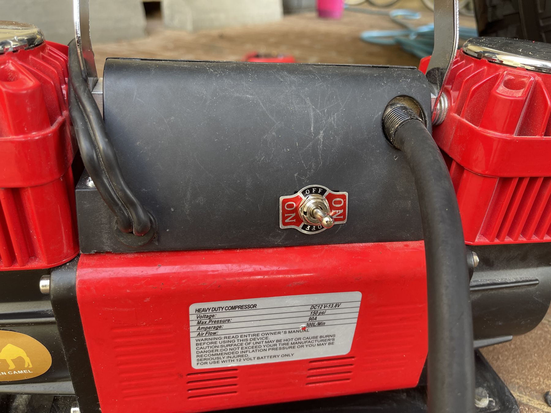

Many off-road members have the Camel double cylinder heavy duty compressor which is an amazing compressor in terms of affordability vs performance, but as with many Chinese branded compressors, reliability is a bit of an issue sometimes.
Luckily most of the faults are related to wiring and the on/off switch. Occasionally there might be an issue with the circuit board inside which contains the relays but this is less common.
If you have a small multimeter with “ohms” setting you can easily measure the continuity and diagnose the fault.
First things to check if your compressor stopped working:
1) Wiring. Have a look if the wires are not cut or damaged.
2) Battery clamps: the wires are soldered onto  the battery clamps and sometimes become loose:
3) On/off switch. This is the most common failure as sand gets inbetween the contacts and eventually it will stop working:
in this above case the switch was faulty and was replaced with another model. You’ll find these switches on Amazon or some shops in Deira.
So if you ever start experiencing problems with your compressor, have a look at the above most common root causes before buying a new model.
