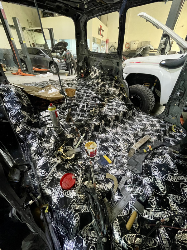

As most of you Dakar drivers would know the road noise in the cabin of the Pajero gets up there at times, has anyone put in sound deadening. What areas had the most effect.
I have done the floor and will start the rear 1/4 panels next. Plan is to do the doors last.
The rear section had no sound proofing at all, that seams to have made the biggest difference so far, with the passenger foot well close behind

Possibly I will over the tunnel and the fire wall, will see what sort of difference I get with this first. Just doing the rear cabin has made a big difference
Just done the last of the drivers side foot well and did both doors, wow what a difference, huge change in the cabin sound.
There was zero sound proofing in the doors, I think this is the biggest area for sound In the cabin. Definitely will do this on all cars from now on.
its so quite at 120, haven’t done the rear 1/4 panels or the rear door yet but the loudest noise now is the air con vents now.
At 120, on the same road at the same time of day I was getting 82-85db
today after the insulation I got a average of 71 -74db.
definite improvement, can still hear noise from rear wheel wells so that’s on the list next.

Used this stuff, probably better out there but it seams to do a good job, have used two boxes for the SWB. Probably need another half box to finish the rear 1/4 panels.

Rear Wheel Wells, Front Firewall, Front Doors and Roof Liner are the best places to reduce outside noise to the driver. I actually created a Word doc for the garage with a list of example applications, lemme see if I can upload that here...
