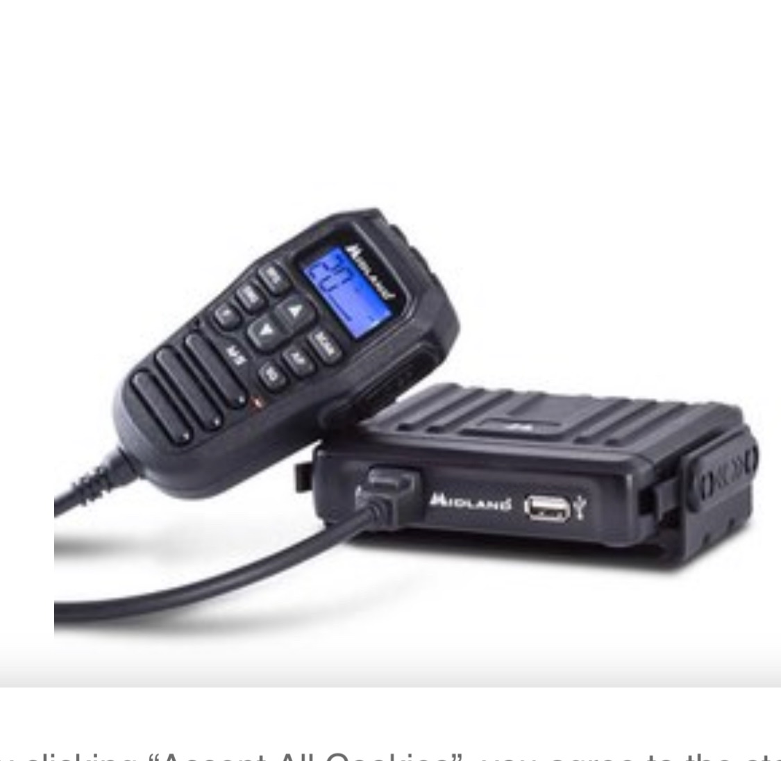

I was recently looking into installing a CB unit in my patrol and hide it inside the center console with a rj45 socket as per the below. But can't find a unit that has a display in mic/speaker that works with the frequencies we use.
  • WOW (+2) 1
@Lawrence_Chehimi I used CB radio (462 range) and they are pain as they are fixed unit and you cant step out with radio.
We are using licensing free frequency (446 range), maybe that's why those CB units doesn't cover that range.
