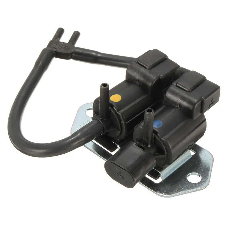

If the Pajero senses that the front wheels are not disengaged, it will throw this blinking light to notify you. As a first thing what you can do is go underneath the car where you will find the vacuum actuator looking like this:
Genuine Front Axle Freewheel Clutch Actuator for Triton 4WD & Pajero ...
Verify if the vacuum hoses are not loose or broken off. This is the first thing you can check before taking it to any mechanic. If the hoses are intact, look for the below mentioned common reasons:
Most common reasons:
1. Vacuum solenoids are stuck or defective. Around 250dhs in Habtoor and can be easily replaced yourselves. They are located next to the air filter box. Most mechanics who have worked on Pajeros can do this in 10mins.
Aliexpress.com : Buy Vacuum Switch Solenoid Valve For Mitsubishi Pajero ...
2. Front differential sensor defective. Not so very common but easy to replace.
FOR MITSUBISHI PAJERO SHOGUN MK2 91 99 L200 SPORT 96 07 FRONT DIFF LOCK ...
3.Stuck vacuum actuator:
We are not allowed to advertise workshops here as we want to keep the forum bias-free. I would recommend to approach your nearest car mechanic and discuss with him if he has experience with this issue. As you can see this is an easy fix and won't cost you much.

Mine started blinking couple months back during one desert drive. But restarting the car did it for the next couple of days... But it comes back. And as Frederic mentioned - it's related to the vacuum system. Funny enough - ever since amazon delivered the part, I have not seen the blinking thing since. I keep the solenoid in the glove box so I can replace it if needed, but so far it didn't come back (since Dec). I told myself that I would replace it anyways next time I'm working on the car... and I forgot completely until I saw this post.
