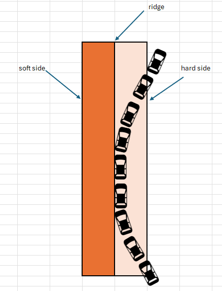

DG707 Posted February 3 Author Share Posted February 3 Thanks for the input @Frederic! You just confirmed my feeling! letâs change the rules now - You have to climb this dune in the manner he did it, but do it safe, what would you do? I feel that car lacks initial momentum, he had to have more initial speed to do this safe way, plus aproach angle was too steep. I have prepared detailed drawing for evaluation đ đ đ  letâs discuss this! 1 Link to comment Share on other sites More sharing options...
Luke K P Posted February 3 Share Posted February 3 i'd say better angle like you have drawn and try for a nice consistent speed to get up to the ridgeline,.. and just turn down early if you can feel you are not gonna make it, loop around, and try again. @DG707 2 Link to comment Share on other sites More sharing options...
Frederic Posted February 3 Share Posted February 3 2 hours ago, DG707 said: Thanks for the input @Frederic! You just confirmed my feeling! letâs change the rules now - You have to climb this dune in the manner he did it, but do it safe, what would you do? I feel that car lacks initial momentum, he had to have more initial speed to do this safe way, plus aproach angle was too steep. I have prepared detailed drawing for evaluation đ đ đ  letâs discuss this! 100% correct. Should be like this: please don't laugh with my graphic skills đ 1 2 1 1 "Go as far as you can see; once you get there, you'll be able to see further." Link to comment Share on other sites More sharing options...
DG707 Posted February 3 Author Share Posted February 3 @Luke K P @Frederic thanks for your input guys, perfect! 2 Link to comment Share on other sites More sharing options...
Gaurav Posted February 3 Share Posted February 3 Correct observation @DG707 If he had carried a bit more rolling momentum, he wouldnât have struggled as much. Gravity wouldnât have worked against him that heavily. At the Newbie level, we always start with the absolute basics: never fight gravity. This principle must be ingrained in every off-roader from day one. At higher levels, we do challenge gravity at times, but only with proper rolling momentum. If thereâs no momentum, or itâs clearly insufficient to complete an advanced maneuver, the correct decision is to back down, reset, and try again, exactly as @Luke K PÂ pointed out. The reason some people still do this is simple: to create a dramatic sand shower that looks exciting on reels. In reality, it often puts the vehicle just seconds away from a rollover. And when a rollover actually happens, those reels never make it to social media. 2 Let's root for each other & watch each other grow. Link to comment Share on other sites More sharing options...
