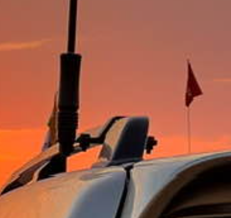

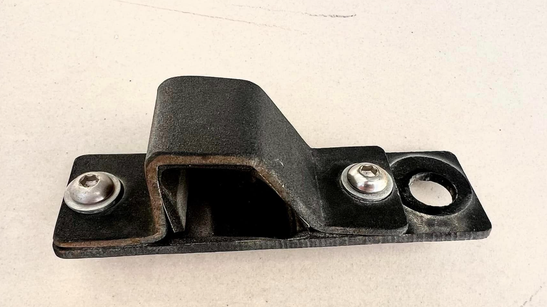

Hi Everyone,
I'm a Newbie; new to Dubai, new to 4*4, new to deserts, new to the club as of 15 minutes ago...  in fact I don't think you could get more newbie than me :-D
I have bought a 2018 Pajero and am looking to get the basics so I can start joining drives.  I saw a mount shaped to the Pajero bars on a FB group (see pictures), I pinged the chap but no response.  Any idea where I can get one of these?  Google searches failed me.
If not, open to other ideas but ideally that don't modify the vehicle.  I'd like to get started before I start justifying chopping up the Tonka Truck!
Thanks everyone!
