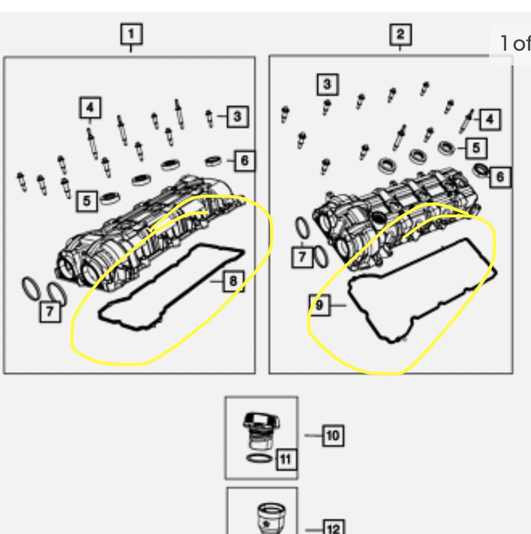

Gary F Posted April 5, 2023 Author Report Share Posted April 5, 2023 An update on the patient: Crankshaft Seal VVL Seal Gasket Cylinder head cover. Timing chain gasket (none available in country) 1 1 Link to comment Share on other sites More sharing options...

Gary F Posted April 11, 2023 Author Report Share Posted April 11, 2023 (edited) I may have misspoke , don’t believe the head gasket went, shall know shortly. 2no gasket cylinder head covers, one of each bank. And a kit of seals to go in the covers. Lttle higher up in the engine for then the head gasket and seemingly a common item to leak as it ages. The covers are made of plastic too. Then we have the pcv valve as you replace at the same time.Then the crankshaft oil seal Followed by The timing chain gasket kit. Plus a some random other seals and a whole coolant refill as the front of the car and radiator came off to get access to the engine. Edited April 11, 2023 by Gary F Update on parts 2 Link to comment Share on other sites More sharing options...

Gary F Posted April 13, 2023 Author Report Share Posted April 13, 2023 Looks like the valve covers were also replaced, engine looks and runs like new. proper test will be tonight’s drive @Benjamin 2 Link to comment Share on other sites More sharing options...
